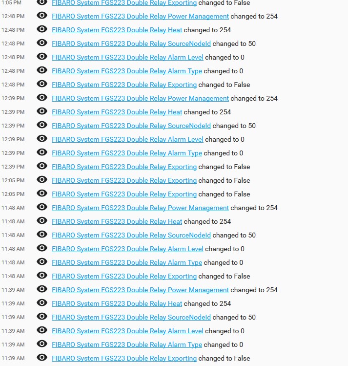

I have 2 Fibaro souble switches. Both of which have irrelevant entities which I don’t like to see in my home assistant log. I added them to the configuration yaml but still they appear in the log. What am I missing here ? See attached images of log file and conf file.

Tried that, but even with 2 space indents I am still seeing these nodes in the log file.
How can I debug this ? Is there a way to see any warnings related to the configuration.yaml parsing by homeassistant ?

I am getting new log report by these “excluded” entities every hour :frowning:
