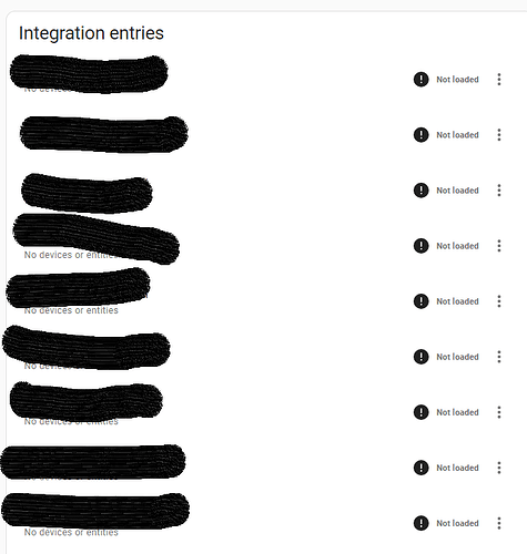

I’ve added a custom component (integration) and there seems to be a fault in the integration. Now I have more then 5000+ entries.
Is there a way to delete? Obviously, manually is not an option…

Unfortunately, SPOOK only has the ability to disable integrations (I’ve tried via Developer Tools > Service) and has to be done manually.
With 5000+ entries/integrations this is not an option.
Also I wish to delete instead of disable… Any thoughts?
