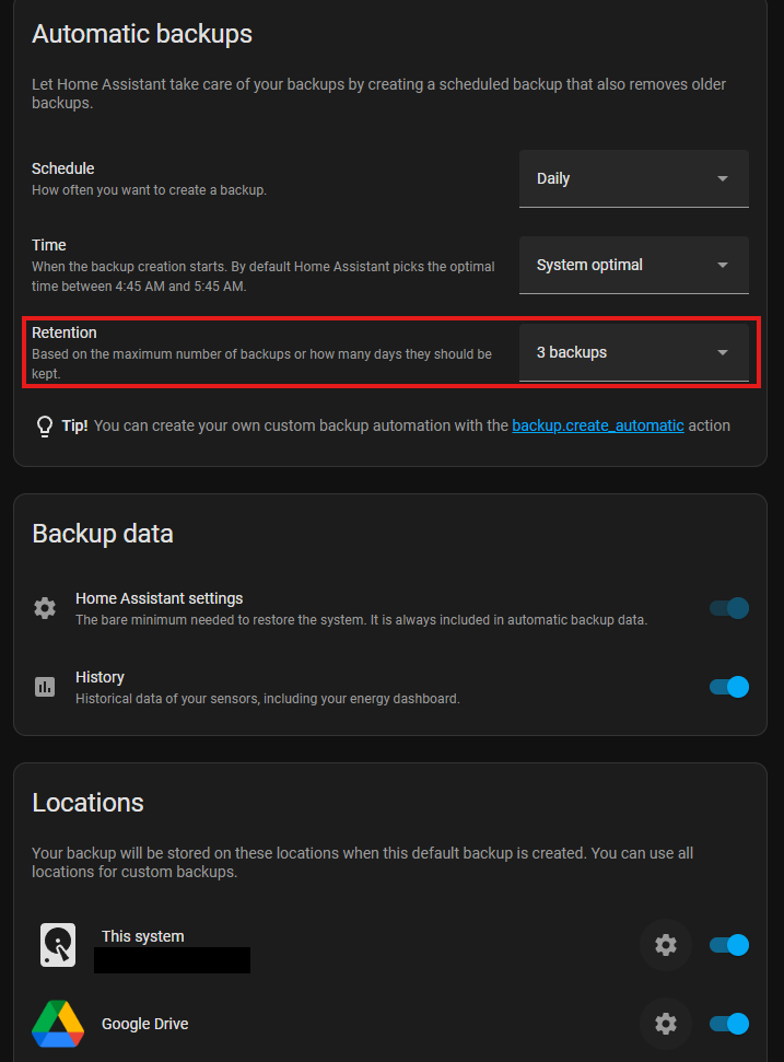

I have Home Assistant connected to Google Drive using the official integration. I have HA backups working successfully pointing to my Google Drive.

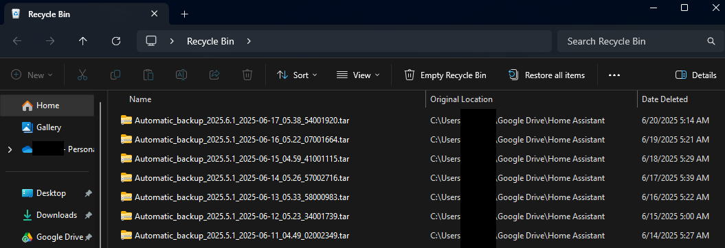

However, I notice on my Windows machines’ Recycle Bins, I am seeing all of the deleted backups show up there after they are rotated out. I then have to manually delete these from the recycle bin to free up space. I would like for the Drive Integration, or even HA Backup, to at least have the option of permanently deleting the older backups.

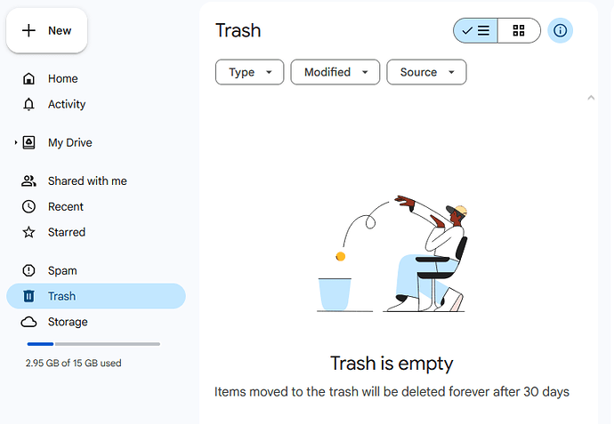

But I too see nothing in my Google Drive Trash folder online. So it seems the Google Windows app is downloading the file locally, then recycling it. This is occurring on all of my Windows PCs where that account is tied to.

Afaik, Home Assistant actually removes the old backups permanently from the cloud storage without moving them to the cloud trash:
However, the Google Drive Desktop client moves the mirrored files which are permanently deleted from the cloud storage, locally only to the local trash. It is probably a safety measure. But in my case the backups in the trash occupy precious SSD disc space for 30 days until they are automatically deleted from macOS.
