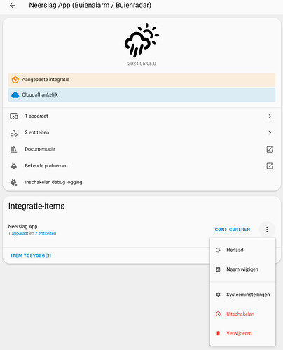

Deleting integrations is in the three dot menu in the integration page:
Removing credentials for integrations that cannot login properly is in the three dot menu on the top right of the page that lists all integrations.
Thanks. I thought removing the config still leaves a trunk of the installation. I removed and reinstalled again and it works now0
