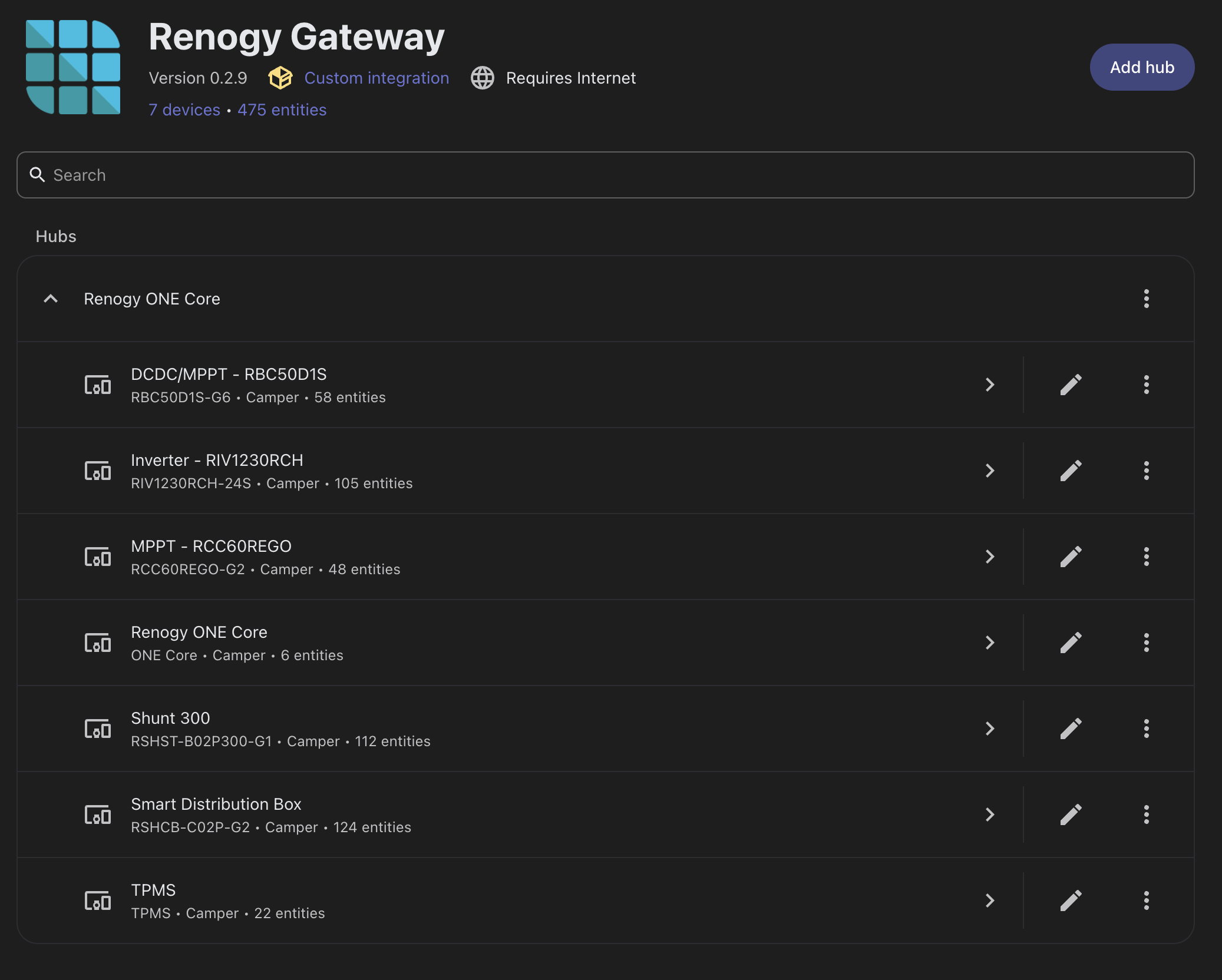

With the help of Claude Code and Cowork I've put together a custom integration for the Renogy ONE Core power system (the smart distribution box, shunt, MPPT/DC-DC chargers, TPMS, and inverter/charger that hang off it).
Repo: GitHub - tdack/ha-renogy-gateway: A Home Assistant custom integration for Renogy ONE Core power systems · GitHub
What it does
It talks to the same private "DC Home" gateway API the official Renogy phone app uses (reverse-engineered for interoperability — see docs/PROTOCOL.md in the repo for the full writeup). Once connected, it discovers your rig's devices and fields at runtime — no hardcoded device list — and surfaces:
  • Sensors for telemetry (battery SOC/voltage/current, charger output, tank levels, temperatures, TPMS pressure/temperature)
  • Switches/lights for real load channels, including dimmable ones
  • Numbers/selects for device settings (charge profile voltages, alarm thresholds, battery type, etc.) under each entity's Configuration tab
  • Buttons/switches for Manual/Auto scenes configured in the Renogy app
  • Your own channel names from the app (e.g. "Bedroom Light" instead of dc_10a_1) carry through automatically
It's push-based (WebSocket subscribe), not polling, so updates arrive as the gateway pushes them.
