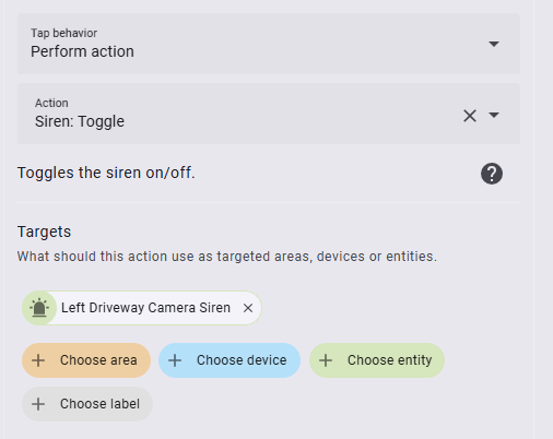

Hi starkiller, my CX410 doesn’t seem to do the siren call. Is this how you set this up? Thanks!
Toggle will likely not work, you should be using siren: Turn On.
Rest looks good.
Also make sure you have the latest firmware installed on the CX410, there was a bug in its firmware that prevented the siren from working in HA.
