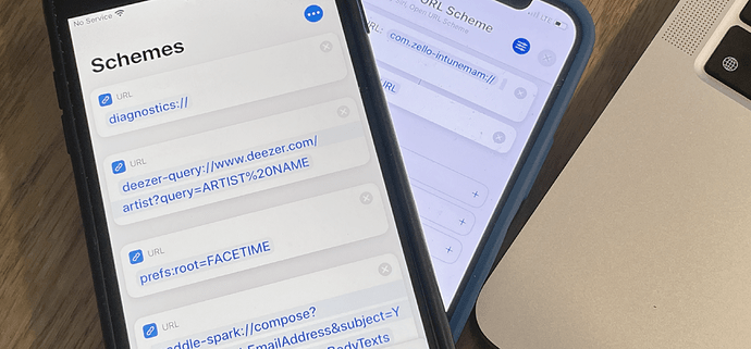

This is the way to find deeplinks, I haven’t tried it but I’m very interested

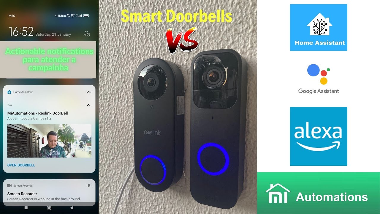

Someone on youtube managed to do this,
Hope someone that speaks his language can ask him.
google translate to the rescue? :joy:
On a related note,
what is the equivalent of this for iOS?
uri: "app://com.twitter.android
I tried
uri: twitter://
and it just open/close home assistant app in an instant.
