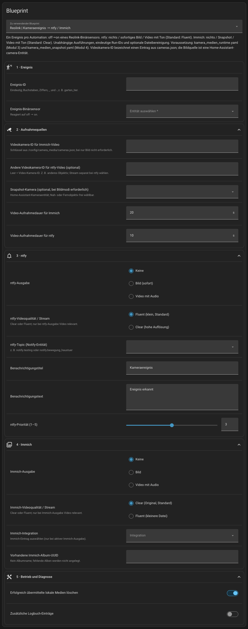

I’ve built a Home Assistant Blueprint to capture Reolink camera events and send snapshots or videos to Immich and/or ntfy.
The main motivation: Home Assistant’s native camera.record occasionally struggles with Reolink Clear streams, and simultaneous recordings can be problematic. So I took matters into my own hands.
Features
  • Event-based automations: One Blueprint, multiple independent camera events
  • Parallel recordings: Independent FFmpeg recording processes, even from the same camera
  • Immich: Upload snapshots or original-quality videos directly to albums using the Immich integration
  • ntfy notifications: Instant snapshots or short videos with audio
  • Flexible streams: Choose Clear or Fluent independently for ntfy and Immich
  • Dual-lens support: Select wide-angle or telephoto lenses
  • Automatic cleanup: Optional deletion of successfully processed files
  • Debugging & error handling: Home Assistant traces and persistent error notifications
The project runs successfully on my own setup, so I thought I’d share it with the community.
GitHub: ha-reolink-media-events
Installation instructions and all required scripts are included in the repository. Please note that the Blueprint requires a few additional Python scripts and Home Assistant packages.
