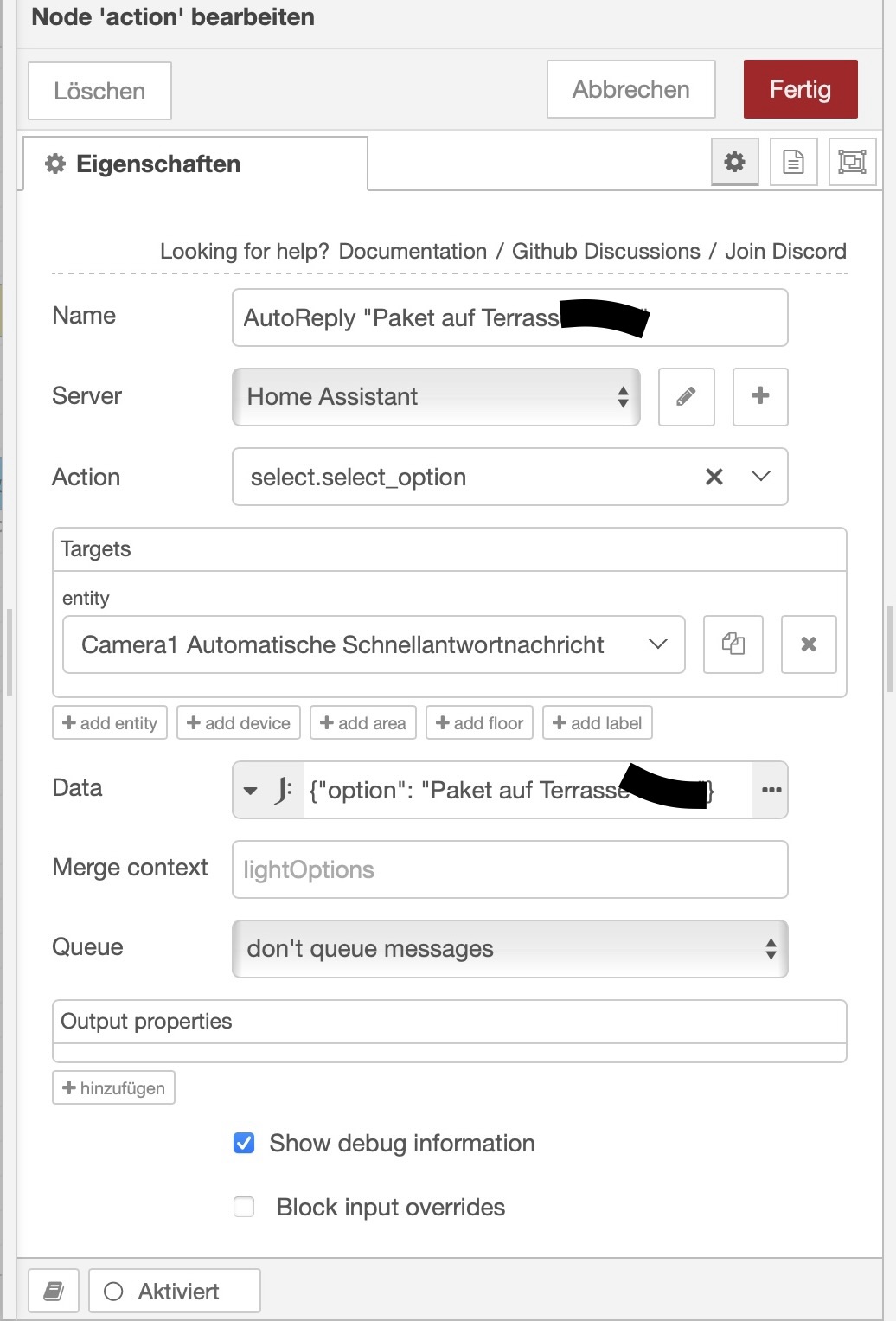

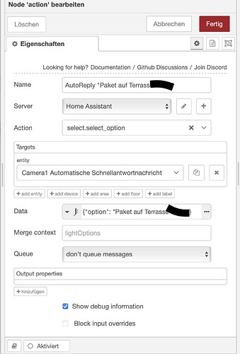

This does not seem to be a general problem. My integration can “see” the recorded custom messages. I can select them by their name (not by an ID). I use Node Red to do this, but since Node Red only calls Home Assistant functions in this case, it should work just fine without Node Red.

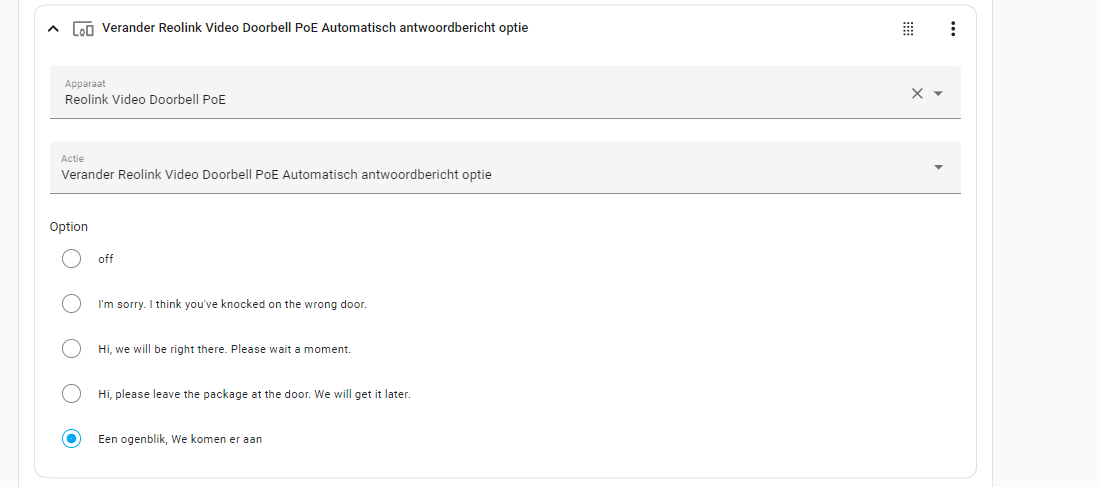

I just checked the HA automation options, and things seemed to have changed in the last year, and more options are now available.
I have reconfigured HA to set the message off when I am not home, and enabled the messages to my custom message when we are home.
I will test this in the upcoming period and post back if it works or not.
New config options:
Named messages, including my own recording and off.
