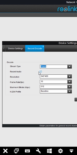

Would you mind posting your settings:
Resolution?
FPS?
Max Bit?
H.264:?
Thanks

You could also try a lower FPS at higher resolution, may help.
I just found a way to reduce the resolution, but for some reason (glitch/bug) it goes back to auto.
It really reduces the preview to very low quality, but as soon as leave the app, it goes back to normal.
Similar for recording, I guess it works fine.

But some questions.
-This is the record settings, so will it affect the streaming? Or just the recordings?
-There are 2 setting, fluent and clear. Are they related to the “sub” and “main” that we choose in the config.yaml? If yes, then it seems sense.
-The reason why I can’t get good results be related with Internet speed? I really meant to say internet and not intranet by wifi. It seems odd, because on smartphone I can see it perfectly. Anyway the pi is connected via wifi, so it has to receive the stream via wifi. Would I get better results with the pi over ethernet?
Thanks in advance.

Although it is the record settings i think it is stream as well - if you lower the clear settings and compare the live stream to a clear stream with high settings you can see a difference.
Yes - I believe low/fluent/sub are all the same things. Same for clear/high/main.
