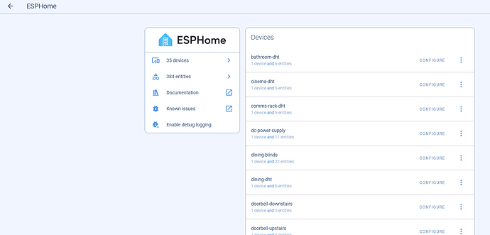

I open the device in …Devices and edit the settings, and the “Enable Device” is on:
Can anyone think of an easy fix, or should I simply delete the device and reinstall it?

Deleting and re-adding won’t fix this. If your device provides services (actions) you need to allow this in the config flow, like the repair says to do:
