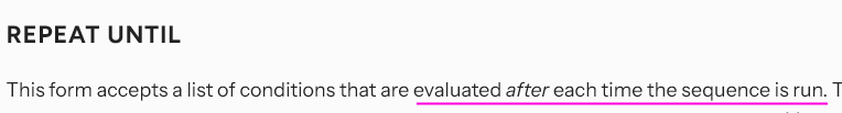

Unlike triggers, conditions do not require the state to change. They are evaluated at the time they are called.
https://www.home-assistant.io/docs/scripts#repeat-until
So your sequence always runs at least once. It will not repeat a second time if the conditions are true before the sequence starts.
As opposed to:
https://www.home-assistant.io/docs/scripts#while-loop
Where the sequence will not run (even once) if the conditions are false before the sequence starts.
