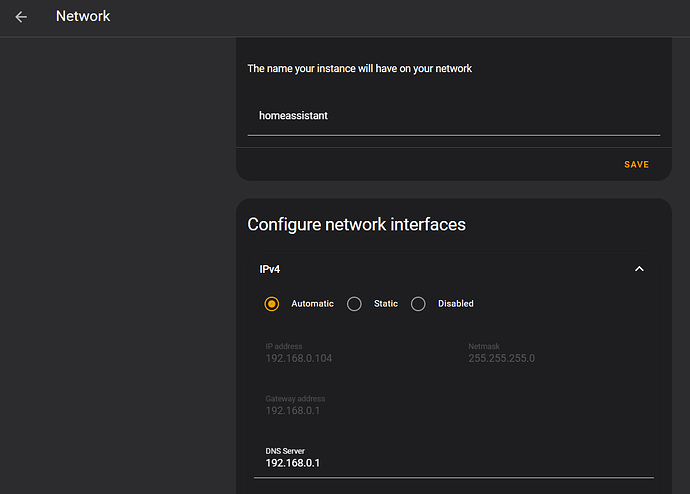

So it’s not connected straight to your modem then? What ips are listed under DNS on the Green? You need to check that in the HA GUI.
Can you advise where to find that screen please.
Got it but its all grey and shows external access disabled
Settings → system → network
Got it but its all grey and shows external access disabled. How do I enable it
Don’t worry about external access for now, is there nothing listed in the DNS settings?
Actually it seems okay see below

DNS Server
192.168.0.1

Seems correct as far as I can see, you can try adding a DNS server (Cloudflare for example), save the settings, do a reboot of HA for good measure and see if that helps with the internet access.
Added Cloudflare no problem rebooting now. Maybe internet access is not the problem but??
Yeah, seems that the issue is something other than internet access, at least your ip settings looks good. I don’t use Alpha ESS and Weatherlink so I cannot help you there.
