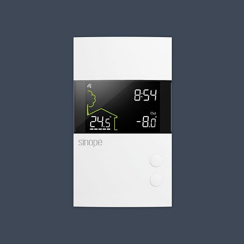

I have a dozen of these thermostats integrated in HA. They work very well and double as ZigBee routers.
The gateway is optional if you use Z2M or ZHA. Only required for Firmware upgrades.
