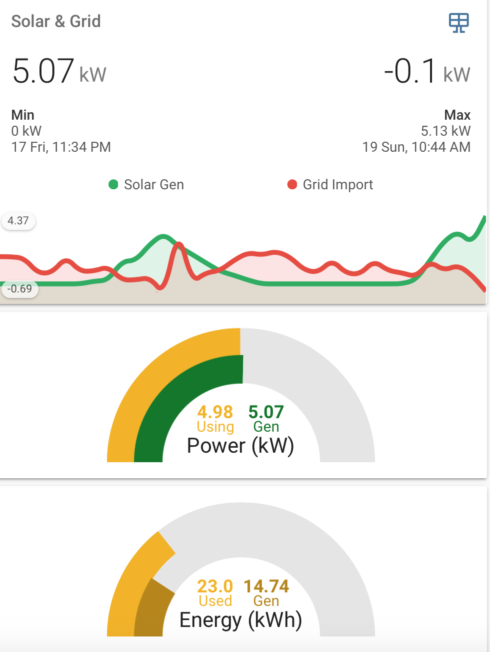

Sure.
Add dual gauge and mini graph plugins from HACS.
Dual gauge
inner:
colors:
- color: var(--label-badge-green)
value: 30
- color: var(--label-badge-yellow)
value: 10
- color: var(--label-badge-red)
value: 0
entity: sensor.fronius_day_energy
label: Gen
max: 80
min: 0
outer:
colors:
value: 40
value: 20
- color: var(--label-badge-blue)
value: 0
entity: sensor.energy_consumption
label: Used
title: Energy (kWh)
type: 'custom:dual-gauge-card'
Mini Graph
entities:
- color: '#27ae60'
entity: sensor.fronius_panel_status
- color: '#e74c3c'
entity: sensor.fronius_house_load_pos
show_state: true
- aggregate_func: min
color: gray
entity: binary_sensor.night
show fill: true
show legend: false
show_line: false
show_points: false
show_state: true
smoothing: false
y_axis: secondary
hours_to_show: 72
name: Solar & Consumption
points_per_hour: 1
show:
extrema: true
labels: false
labels_secondary: false
smoothing: false
state_map:
- label: Day
value: 'off'
- label: Night
value: 'on'
type: 'custom:mini-graph-card'

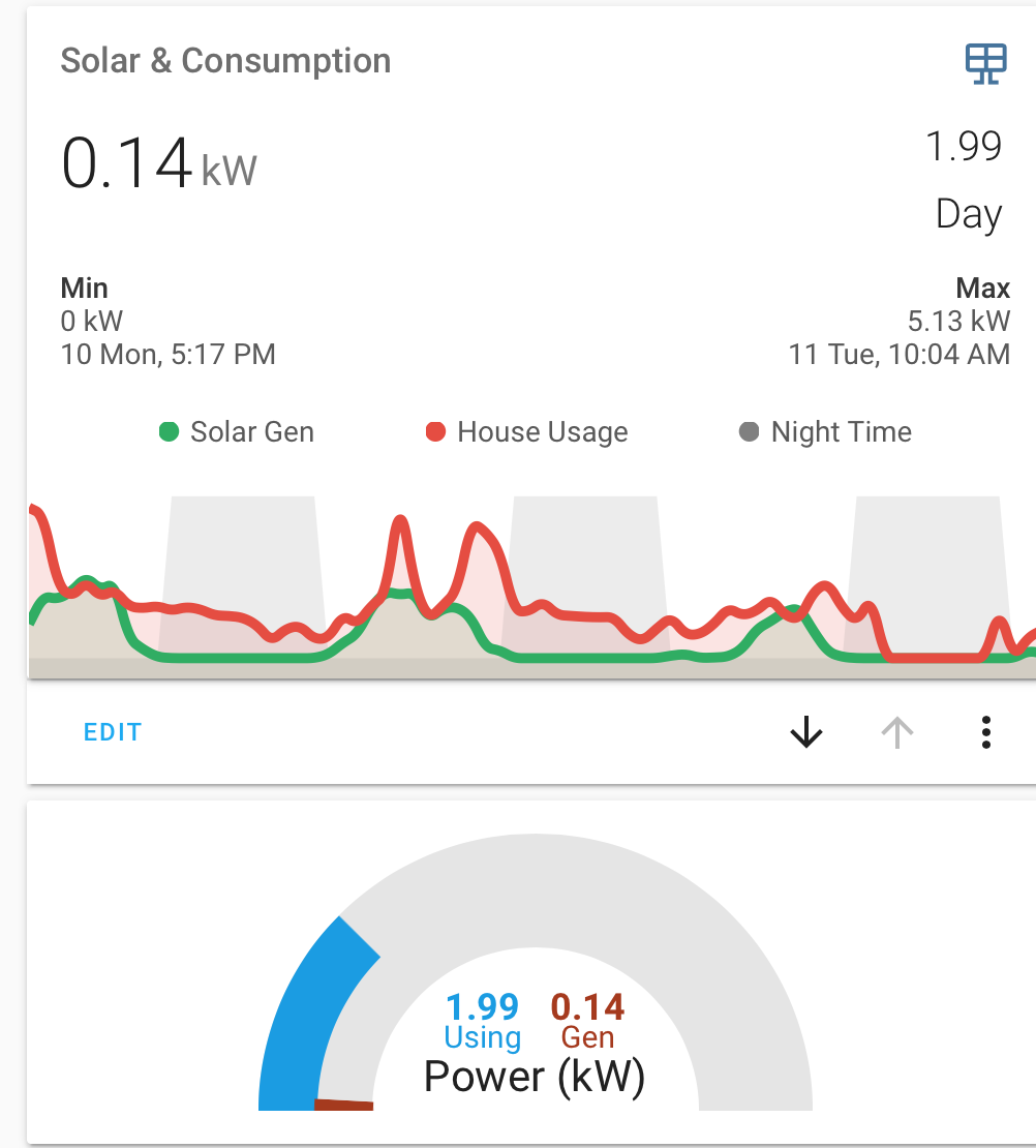

Delbz
(Marcus)
February 12, 2020, 10:25pm
8
I have updated this since I originally posted so the above code makes it now look like this
