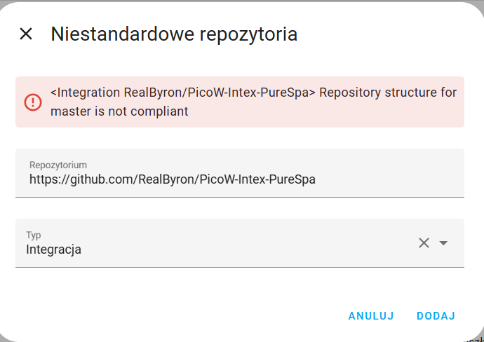

i have the same problem. This is integration for my Intex PureSpa. I dont know what is the reason of that…
that’s not an integration, that’s firmware for an esp device
