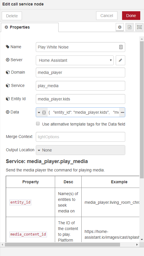

Would be very happy if someone could share a screenshot on flow on how to initiate cast local file to chromecast and also a screenshot over the parameters for the chromecast node (see url to file).
{ "entity_id": "media_player.kids", "media_content_id": "https://BASEURL:PORT/local/media/longwhitenoise.mp3", "media_content_type": "audio/mp3" }
This help?

Thanks! Was thinking the “Cast” node should be used, never thought of this. Regarding the url, where have you put the local file - I don’t see any “local/media” (im running Hassio in docker)? I was able to stream a mp3 from the web.

www/ becomes local.
