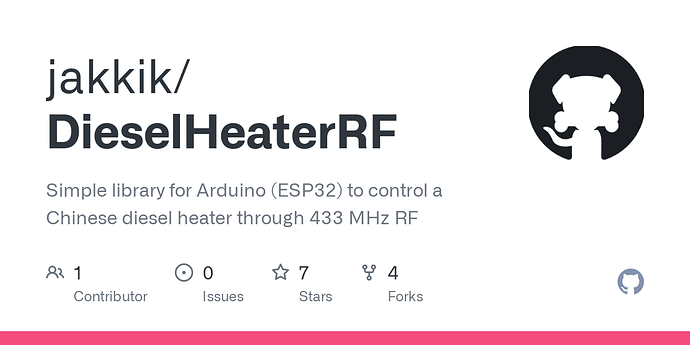

Guys! Go show your interest on this on my GitHub feature request if you are interested in this integration.
opened 07:14AM - 14 May 23 UTC
<!-- READ THIS FIRST:
- This is for feature requests only, for issues please g… o to the issues repository.
- Please be as descriptive as possible, especially use-cases that can otherwise not be solved boost the problem's priority.
DO NOT DELETE ANY TEXT from this template! Otherwise the issue may be closed without a comment.
**Describe the problem you have/What new integration you would like**
Integration for the Chinese Diesel Heater models using the RF remote control
**Please describe your use case for this integration and alternatives you've tried:**
There are no solutions, but there is already an arduino library available for this here
https://github.com/jakkik/DieselHeaterRF
**Additional context**
Would love to see this integrated in HA and ESPhome and sure there are many people who could use this integration.
