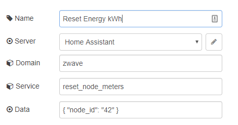

Yeah I half figured it out. Not sure what is up with the automation code posted. I did change the node-id and it still wasnât working. I moved it over into Node-Red anyway since thatâs where most of my automations now live and this worked like a charm:
