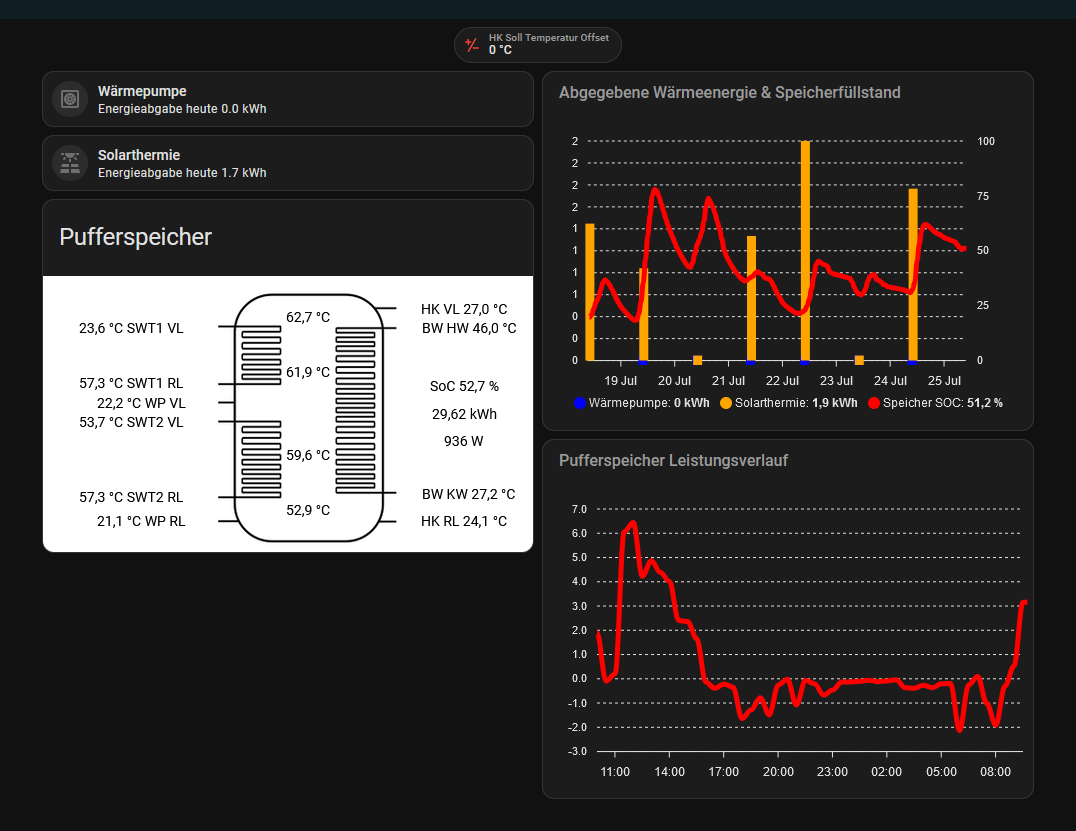

I would like to share this Dashboard with you guys.
Thank you Martin!
