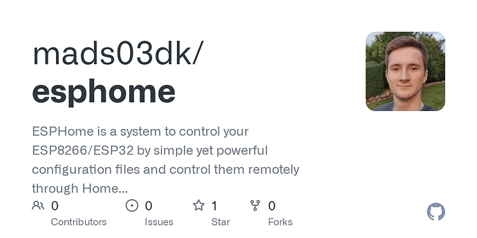

User mads03dk har started something here on snapcast for esphome.
