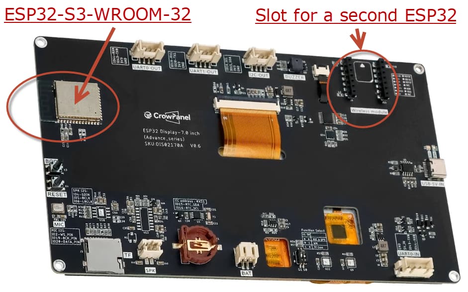

Do you think it would be possible to use the “ReSpeaker Lite 2-Mic Array” USB board without ESP32 (or alternativly the FutureProofHomes Satellite1 Dev Kit) in combination a ESP32-S3 development board and one of these 7-inch series of capacitive touchscreen displays from Elecrow in order to make your own variant of a Home Assistant Voice Satellite with a screen? …i.e. something similar in design to Google Nest Hub and Amazon Echo Show :wink:
At least these “CrowPanel Advance” display series features “replaceable wireless modules” meaning that the ESP32 module can be replaced. That is, this article says that they feature an ESP32-S3-WROOM-1-N16R8 module soldered on the back + having a pin header taking ESP32-H2, ESP32-C6 or…
The specificiation does say that it also features a built-in microphone (however I assume that is rubbish) as well as a speaker connector (but no mention of a DAC).
The also have loads of different models with various sizes of screens. With the “Advanced” series all having a pre-soldered ESP32-S3-WROOM-1-N16R8 module:
CrowPanel Advance ESP32 displays are available on Aliexpress from $25.99 up to $54.19 depending on the selected model and whether any of the wireless modules shown above is added as an option. But you can also purchase the displays and wireless modules on Elecrow’s company’s store. Again see:
I’m not sure there’s enough of resources to hold all this functionality on single S3 tho…
You can try on FPH Sat1 - all free GPIO pins are exposed there. :slight_smile:
Look again, my point would be to use two ESP32, not just one.
I got confused with your link to Respeaker WIIHOUT ESP32, and mention of dev board. :slight_smile:
Multi-chip boards are hard…
The surcharge for the second module is also comparable to the surcharge for a Respeaker Lite WITH its own Xiao, so not sure why you would bother with all the complications…

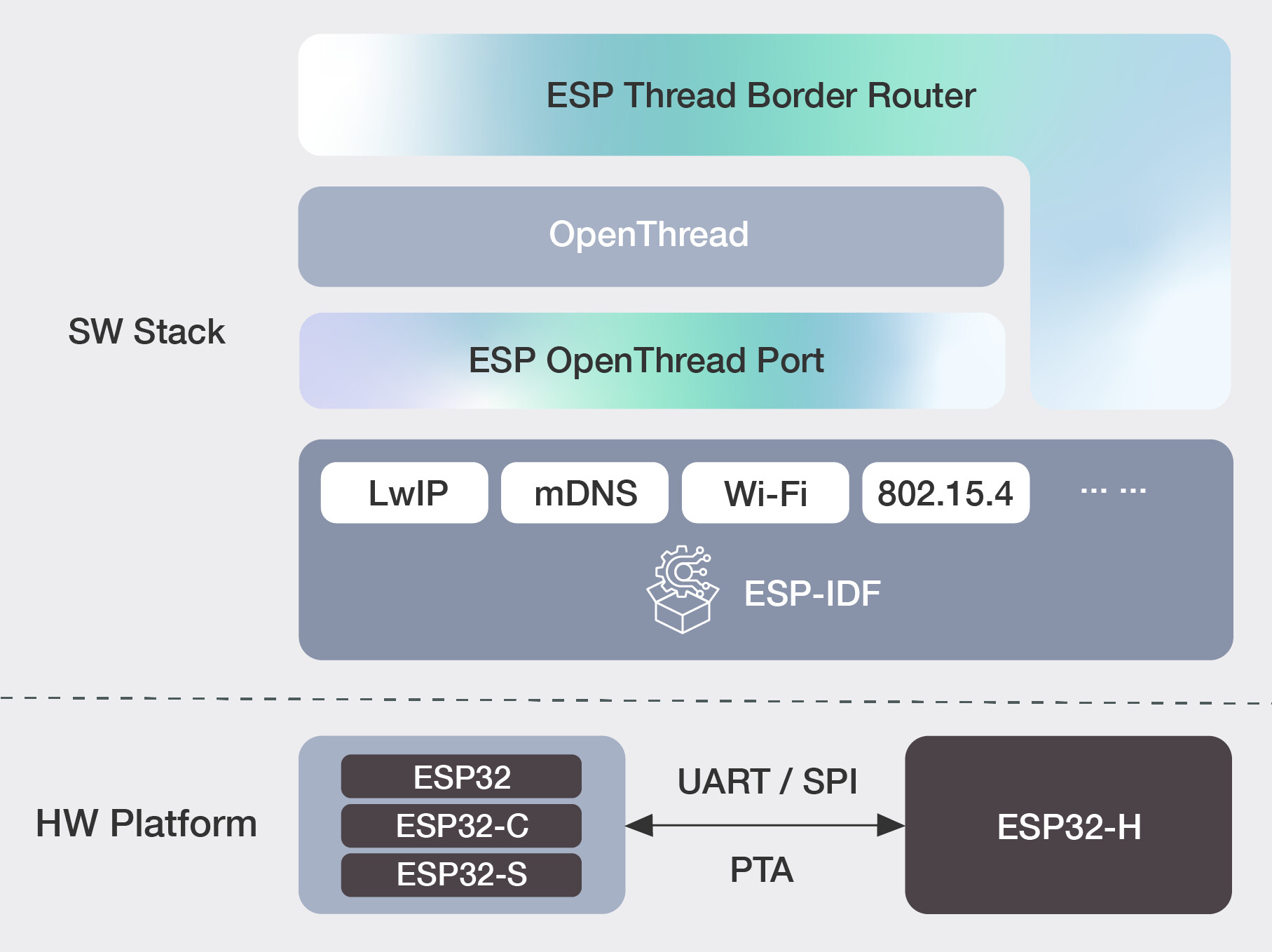

I meant if they second ESP32 could be connected via SPI kind of like the Espressif’s ESP Thread Border Router SDK hardware (based on ESP32-H2-MINI-1 module):
OpenThread Border Router Example as in a similar two-SoC setup combining both a ESP32-S3 and ESP32-H2 in the same solution:
I totally understand. Just saying that it’s hard. :slight_smile:
