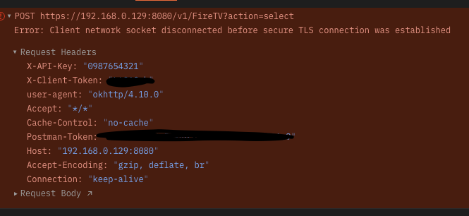

Sorry haven’t contacted you, works been wild. On the list. I am currently getting TSL issues. I have tried the commands in Postman and the same issues are presenting. Photo attached.
Remote wake command on HTTP still works fine.
What does the response say? During my testing lately. One of my older sticks decided to reset itself and needed the token reset. So far my newer ones have been okay but my older one seems to run out of memory every so often and reboots/resets itself.
My Postman has refreshed or something and the history is gone Sigh
Weirdly today its fine, no TSL/SSL issues. I haven’t changed a thing. Is there like a time out thing you’ve come accross these things at all?
The only time out thing I have seen is just the fire tvs going to sleep at least so far. Looking at your screenshot it does look like maybe the content-type was missing. We did discover it requires that for it to go through. But without any changes it seems pretty odd.
