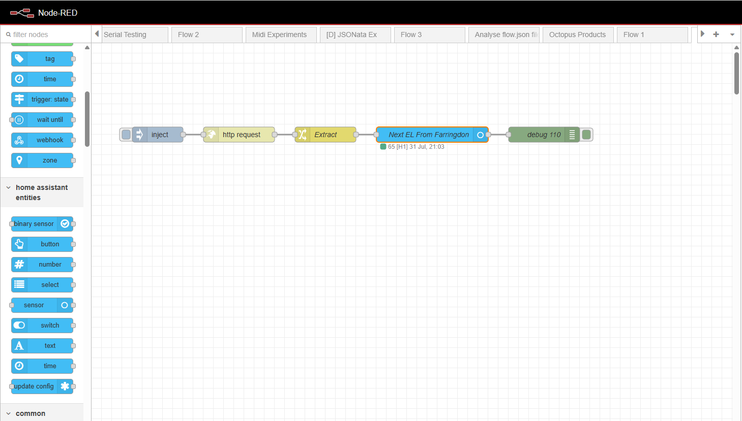

A case where the use of Node-RED is so very much easier.
Flow:
Result:
Effort: 5 minutes work at most (in fact, it took me longer to write this response than it took to write the Node-RED code).
Whats more, I have JSONata to pre-process the result - select fields, sort by platform, turn UTC timestamps into local time…
Only if you know nodered and how to install, config and map to HA… I am a big (!) fan of nodered but not sure if this is simpler by-default.

The NodeRed solution may be a good one but I tried Node Red quite a few years ago and apart from the nice GUI I found it didn’t add anything for me that I couldn’t do without it (maybe notwithstanding the current example) and it seemed like an unnecessary ‘overhead’. I am not inclined to use it now for one solution.
But as I said - I see the benefits of it if that is what you choose.
