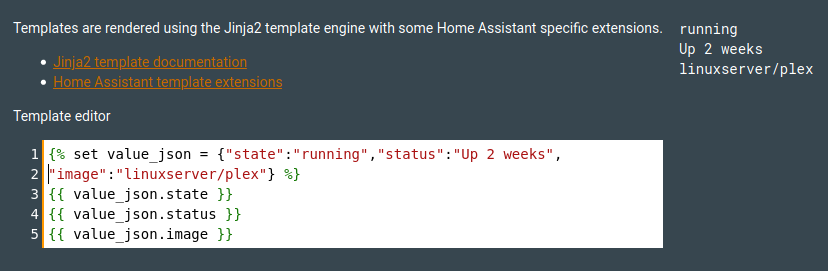

There are multiple examples in the Restful sensor docs howto get values from a json response.
As a start, copy and paste the output of your sensor in Dev Tools/templates to a variable and play with it.
Thanks, this got me going in the right direction so thanks for the reply and I think I understand templates a little bit more now so thanks for that also!
