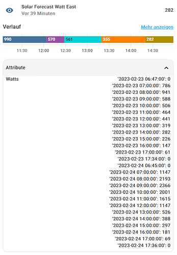

via the rest API. What I would like to have is that the values in the attribute list get updated each 1h10s, but the value of the sensor should get checked and (if needed) updated each minute. (In the Image you can see that I last restarted at 12:28 and since then each 3610s the values get updated, even there are new values in the attribute list for each full hour.) I hope I could explain it clear enough ^^
