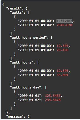

It looks to me that you data is not a single string, the key is the data and the value is the watts. So it should just be value_json.result.watts[0][1] (no split). Or maybe even value_json.watts[0][1] without seeing what is in the JSON response, I do not see where result is but it must be there if the top screen works.
In developer tools, you should enter:
{{state_attr('sensor.solar_forecast_east_watt','watts')[0][1]}}
and see what you get. Test various variations there and then you will see the proper way. I would think the above would return 1142 given the numbers above, the second entry is a 0 indexed set.
Thanks for you help. In the developer tool I get the following error:
Is there a way to look at the raw JSON response in HA? I believe it should look like this:
Use “| tojson” so:
{{ state_attr('sensor.solar_forecast_east_watt','watts') | tojson }}
I now found out that it is working if I put the date/time in the []
Now the question is how I can make it change each hour… So somehow I would have to read in the actual time and compare it with all entries of the json…

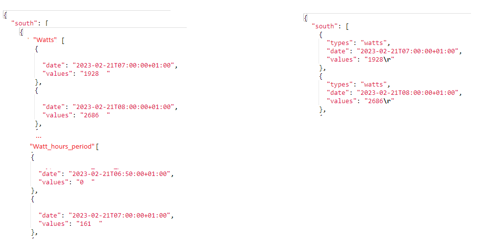

Thank you, I just tried to do it, but I didn’T succeed. In the csv output I the as .[0] watts,watt_hours_period,watt_hours,watt_hours_day as .[1] the date/time and as .[2] the value.
How can I archive something like on the left side in the image?
At the moment I get something like on the right side. My jq code looks the following:
{ south: [inputs | split(";") | {types: .[0], date: .[1], values: .[2] } ] }
The complete .csv output can be found the post above: REST sensor pv forecast postprocessing issues - #11 by u20p17
Here ya go:
{ south: [(inputs | split(";")) | {label: .[0], date: .[1], values: .[2] | gsub("[\r]"; "") | tonumber } ] |
group_by(.label) | map({ key: (.[0].label), value: [.[] ] }) | from_entries

I could not quite figure out striping the label from the object but just don;t use it, not much data there anyway. I did include stripping \r and converting the values to a number.
Update:
Just change like this:
group_by(.label) | map({ key: (.[0].label), value: [.[] | {date: .date, values: .values}] }) | from_entries
If you want to remove the label:

I now tried to add the following sensor to the configuraion.yaml:
  - platform: command_line
    scan_interval: 3610
    name: Solar Forecast East
    command: "curl -X 'https://api.forecast.solar/estimate/47.00000/15.000000/45/-10/10?time=utc' -H 'accept: text/csv' -H 'X-Delimiter: |' -H 'X-Separator: ;' | jq --raw-input '{ south: [(inputs | split(";")) | {label: .[0], date: .[1], values: .[2] | gsub("[\r]"; "") | tonumber } ] | group_by(.label) | map({ key: (.[0].label), value: [.[] ] }) | from_entries }' "
    value_template: "OK"
    json_attributes:
      - watts
      - watt_hours
      - watt_hours_period
      - watt_hours_day
Nevertheless, I get an bad indentation error in the “command:” line. When I remove the
the error does disappear. So it must be somehow in the jq code, which is working in jqplay :frowning_face:
You need to escape the inner double quotes because the whole command is inside double quotes the ones inside the JQ template need to be escaped. You do this by adding a \ before every double quote.
    command: "curl -X 'https://api.forecast.solar/estimate/47.00000/15.000000/45/-10/10?time=utc' -H 'accept: text/csv' -H 'X-Delimiter: |' -H 'X-Separator: ;' | jq --raw-input '{ south: [(inputs | split(\";\")) | {label: .[0], date: .[1], values: .[2] | gsub(\"[\\r]\"; \"\") | tonumber } ] | group_by(.label) | map({ key: (.[0].label), value: [.[] ] }) | from_entries }' "
see the entries for the split and gsub parts are escaped. You can see that in the command_line sensor I posted above for the flooddata river level. You aslo need to escape the \ in the \r in gsub. Fixed that in the sample.
Just to be sure you see what I am saying, the gsub should look like this:
and the split like this:
split(\";\")
I would also note that your sample has a key overall of “south” you would need to set the json_attributes_path to “$.south” I believe if you really want the four things below that to be attributes. Or just set the attribute to “south” and then write your template to be below that.
And one last note, the name of your sensor is “Solar Forecast East” and the key is “south” … possibly you are just getting this rolling or maybe something needs correction.
You can’t use json_attributes_path with command_line. I also got errors using -X … here is what works for me:
 ## Test Solar Forecast
  scan_interval: 3610
  name: Solar Forecast South
  command: "curl -s 'https://api.forecast.solar/estimate/47.00000/15.000000/45/-10/10?time=utc' -H 'accept: text/csv' -H 'X-Delimiter: |' -H 'X-Separator: ;' | jq --raw-input '{ south: [(inputs | split(\";\")) | {label: .[0], date: .[1], values: .[2] | gsub(\"[\\r]\"; \"\") | tonumber } ] | group_by(.label) | map({ key: (.[0].label), value: [.[] ] }) | from_entries }' "
  json_attributes:
      - south
Returns this:

Here’s a solution to that which doesn’t involve curl or jq:
  value_template: >
    {% set time_now = now().strftime('%Y-%m-%d %H:%M:%S') %}
    {% set tkey = value_json['result']['watts']
                  |sort|select('le', time_now)|list|last %}
    {{ value_json['result']['watts'][tkey] }}
Returns the watt value of the latest key that is earlier than the current time. I would paste a demonstration, but I’m not typing all that in and you only posted screenshots of the data.
thanks! this is working fine with the original json (Y)
