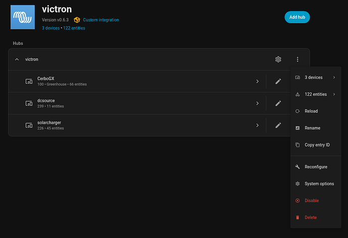

I’ve tried to find a simpler way to restart a service as needed. At present I have a service (device goes offline due to solar/battery output) and I need to restart the service in the mornings which involves going to Settings, Devices and services, scroll down to about the 57th item in the list (no joke), choose service, and reload so it picks back up and shows me data. So, is there a way around that that’s shorter than this post? A helper button, a on/off toggle, anything else?

See first post. I have to reload the entire service once there’s enough light on the panels to start charging. I’m in the PNW of the US and right now there’s so much rain I haven’t had any solar at 9:20AM. Yesterday I at least cracked 100w briefly but much of the day was under 30w. Any solar at all is enough to bring things online.
There aren’t standard entities because it is TCP Modbus. Literally have to restart the service for the CerboGX which the other devices are connected to.
In the image above the whole thing would be in yellow because it went offline. Not like the service is still running but the device isn’t available.

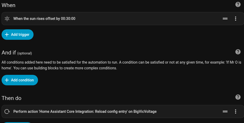

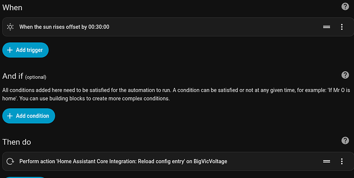

I got a chance to poke it thoroughly last night and managed to find “Home Assistant Core Integration: Reload config entry” that fuatakgun suggested via YAML but in the UI instead and set to reload 30 minutes after sunrise. That actually worked. Thanks for the suggestions and rubber ducking.
