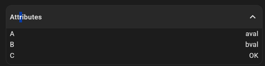

In HA i can even see the attributes being returned

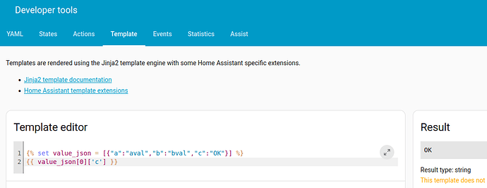

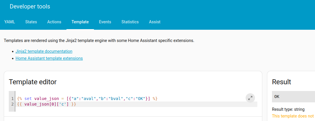

{{ value_json[0]['c'] }}
Your response:
[{"a":"aval","b":"bval","c":"OK"}]
is a list containing just one item. That item is a dict, and you want the value from the c key of that first item. Spaced out a bit more clearly:
    "a": "aval",
    "b": "bval",
    "c": "OK"
Developer Tools / Template is your friend here:
You won’t then be able to specify the json_attributes though: that expects the response to be a dict not a list.
