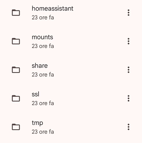

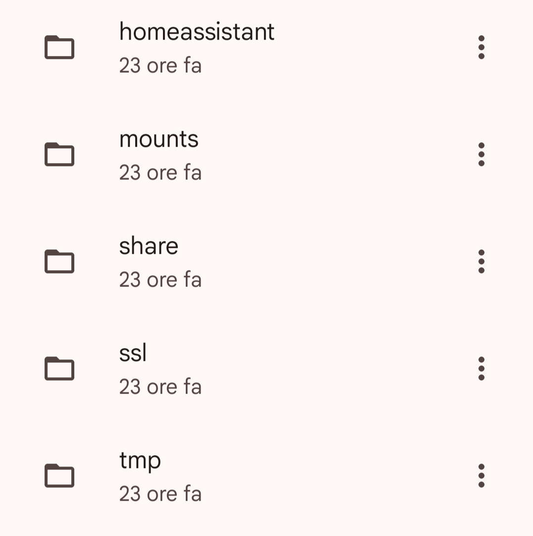

Hi to all, I migrate to raspbian to home assistant os, I make 3 different backup and one manual backup file by file, folder by folder.
I lost only one thing, the backup are encrypted…now I lost my last 4 years of work.
I replaced all files and folders, and now I see the automations, helpers and scripts, only this.
How can I recover at least the graphic part?
Thanks for any help
If you have the contents of the original config folder (including the .storage folder in it) then you can copy that over your new config while HA is down. If you don’t have that and all your backups are encrypted then you are out of luck.
That would be the homeassistant folder (also called config for backwards compatibility). Everything except addons is in there if you also have all its subdirectories. But you can only copy then correctly if Home Assistant is not running.
How can?
With home assistant os what’s I have to do?
