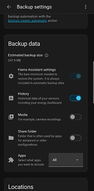

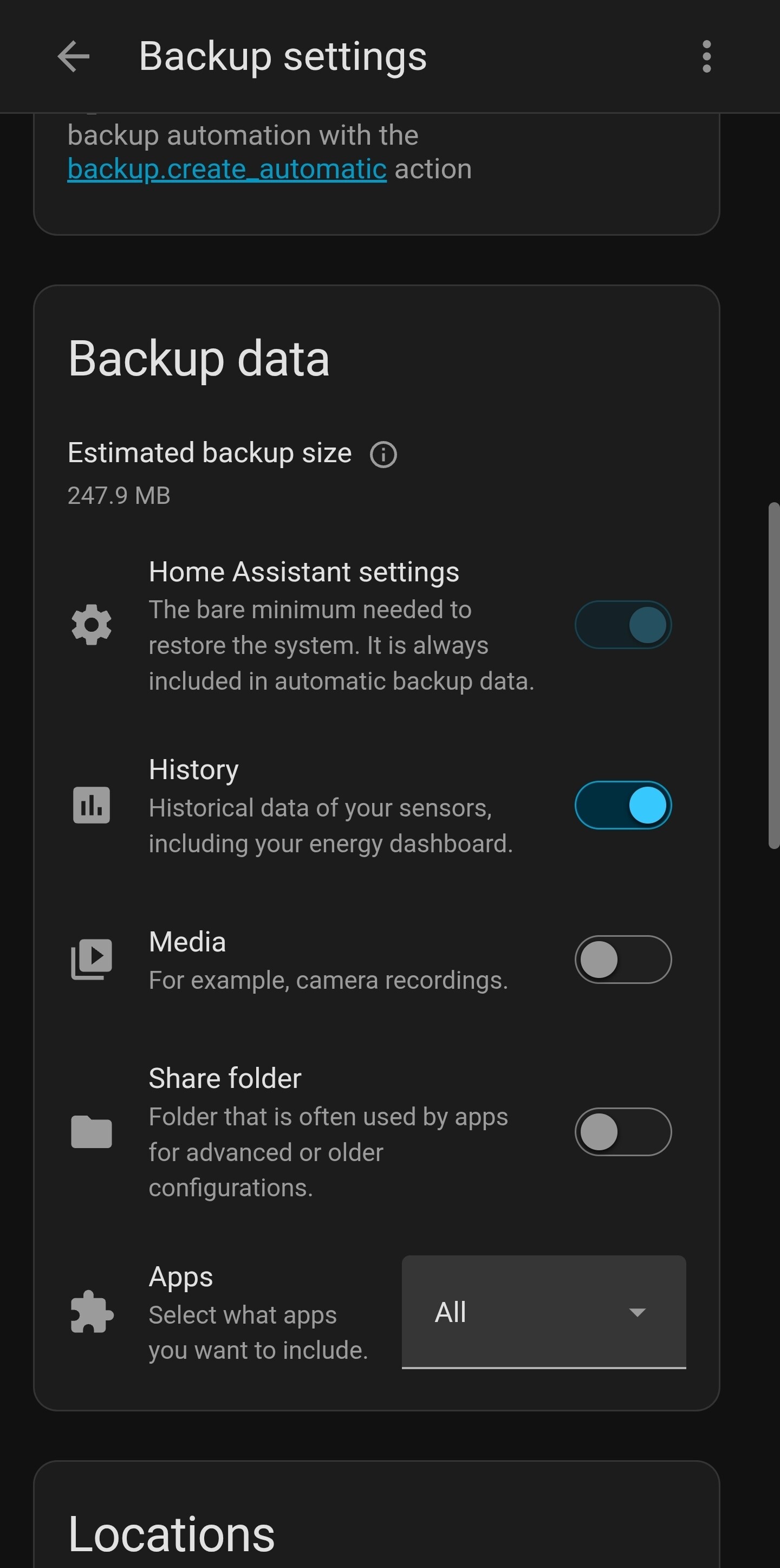

Go into your backup settings and check you have configured it to comprehensively backup everything. If it didn't back it up, it wont be able to restore it.
The restore process reboots it already anyway. I tried again just for good measure to no avail, using Menu > Settings > System > Power button icon > Advanced options > Reboot system.
As far as I can tell from the backup settings screen, I have everything enabled for Home Assistant.
