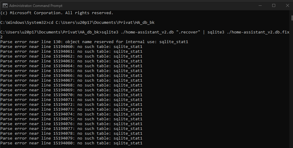

I am trying to fix my database.
Every time a repack is performed (scheduled monthly or manually), the database gets corrupted and starts from scratch, forcing me to restore a pre-repack backup.
I am trying the procedure described here, and indeed the database gets corrected, as shown in the screenshot below. However, once I replace the file in HA and restart the system, the database is detected as corrupted again.
Any ideas?
