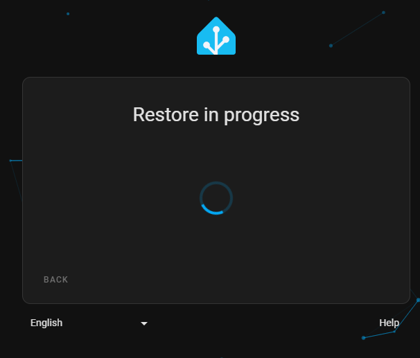

I’m not sure which version of supervisor is running as I have not gone that far in the restore process, it doesn’t sound like it’s a download issue? This is the screen it just doesn’t get past:
I have insomnia so I decided to try this :slight_smile: This is probably the issue you are expereincing per @WallyR … you took the backup from the .3 build.
I’m still running .2, and I just used the Proxmox helper and built a new haos (in a different vlan) and I was able to restore my haos backup successfully.

FYI to those reading, I waited for supervisor 2024.11.4 to be pushed and the restore worked after generating a new backup and creating a new vm using the proxmox helper scripts.
