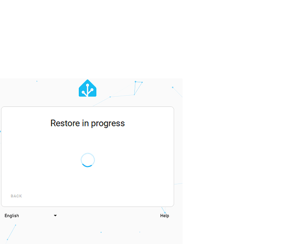

I am on latest everything of Home assistant using VirtualBox 7.xx on x64 Win 11 system. I tried restoring to a backup from this morning 2am. It confirms I want to restore then all I see for a while is this…
How long is a while? Restores takes time.
I actioned it again when I posted this issue. Its still going. Been an hour now. How long is it meant to go for?
It depends. How long should a restore from backup take?
Interesting. I have restored before(2 days ago) which has taken less than 10 minutes and therefore now confused. My backup file is less than 400mb.
