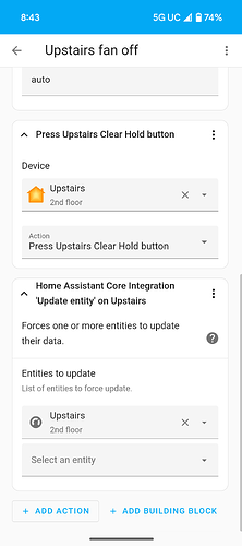

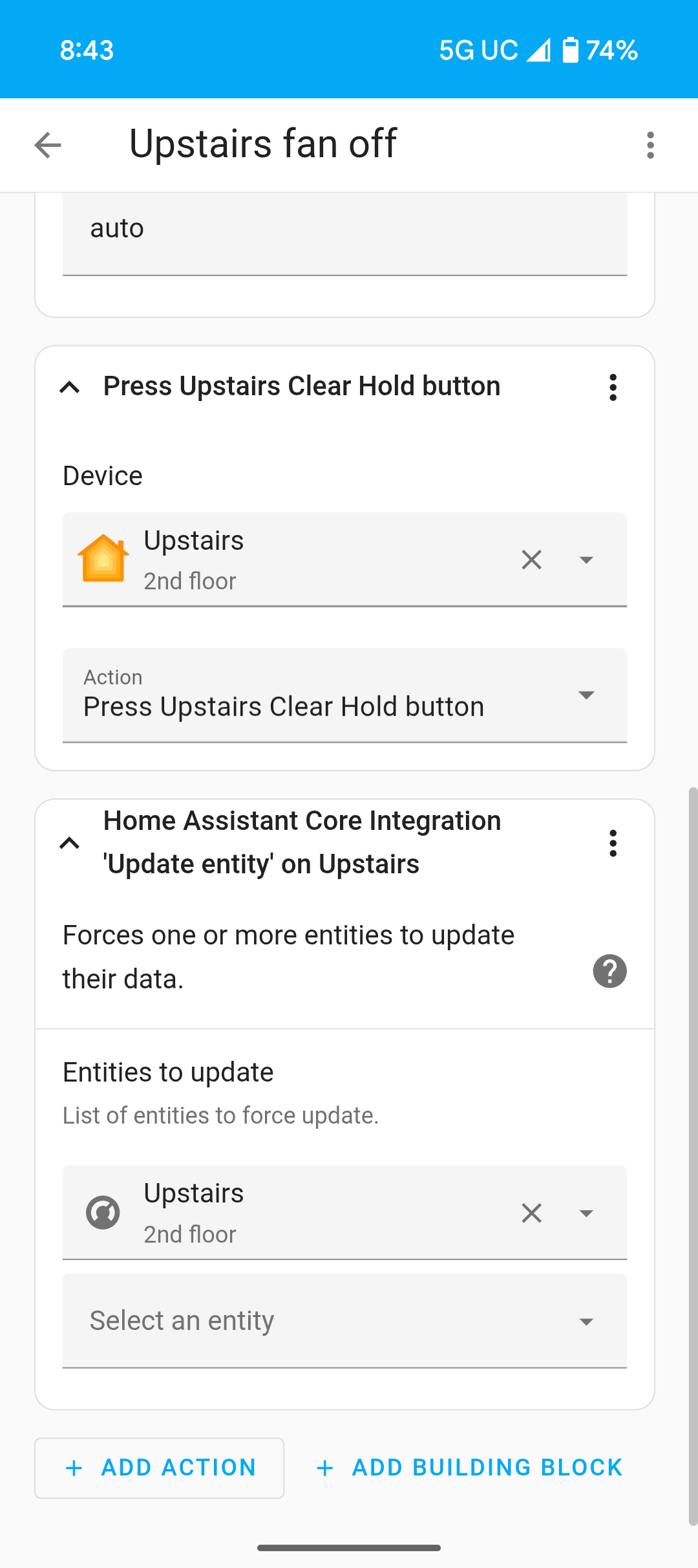

I use the "clear hold’ action available via the homekit integration. I have to do a manual refresh after that to get the thermostat state correct afterwards though
That works! Thanks
Thank you! I have been wanting to move to HK from the Ecobee integration, but was looking how to do the equivalent of the resume_program action I can do with the Ecobee integration.
