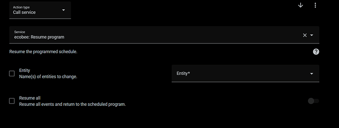

that should work. so you’ve given the thermostat a command outside of the value that’s currently scheduled and when you resume program the ‘hold’ doesn’t come off the thermostat in the ecobee app?
Here is how I am testing. I change the thermostat from Cool to Off. I run this piece of code inside the automation page. Nothing seems to happen, but no error. It says it runs successfully.
Maybe resume program is not what I need. I’m changing the code to this and seeing if this helps.

It doesn’t do that and I know it won’t because it failed today when I accidentally shut off all my units and I resumed schedules it did nothing. You would have to initiate a turn on command then a resume program.
This appeared to work when performed manually. I think my condition is valid (it registers true). So, maybe that solves it. How would you send a turn on command? That could be interesting to do as well if I ever needed it.
looks like this is what’s doing it: climate.set_hvac_mode
I guess I shouldn’t have said turn on, then resume. Set the HVAC mode to heat, cool, or auto; then resume program
Yep, that’s what I’m doing now. Although by default it resumes program when you do it this way. So, resume would only be to come out of a hold. I am not holding, so it makes sense to turn off and then back to Cool. My parameters are for when my electricity pricing goes up and down, so that could be long durations. Thanks for your help. I’ll take what I have here and tweak it as necessary. The main thing that was a problem was that it didn’t turn my AC back on when price point came down.
