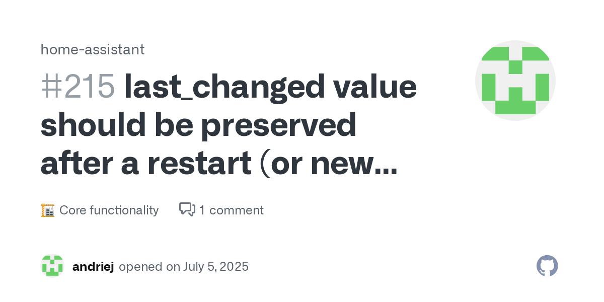

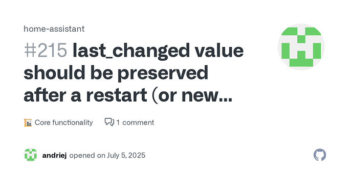

This feature request/issue is also addressed in the new Discussion part of HA github:
At this point I’d recommend to people that if an integration is not retaining it’s state after reboot to request that functionality from the integration author directly. As @petro said, they can be written to have this behavior and it’s not difficult to do. So the more people request it from them, the more likely it is that more integrations will use this feature over time making things better for everyone.
