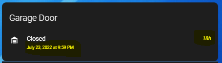

royto / logbook-card:
If the HA logbook card and royto / logbook-card can retrieve and display the correct last transition state from logbook history, why can we not have an HA secondary_info: option like logbook-last-changed?? Better yet, restore the last-changed from logbook; if unavailable because logging not enabled for the entity, THEN set to current timestamp/last-updated…
Oh, and if someone could please explain the difference between last-changed and last-updated I would be grateful! I’ve never seen them differ…
