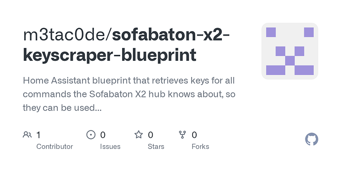

This blueprint fetches all of these for your Activities and/or Devices, and provides ready to use YAML showing how to use the codes retrieved.
You must have the Sofabaton X2 integration installed and working before running the script.
Open your Home Assistant instance and show the blueprint import dialog with this blueprint pre-filled.
More information is available on Github.
