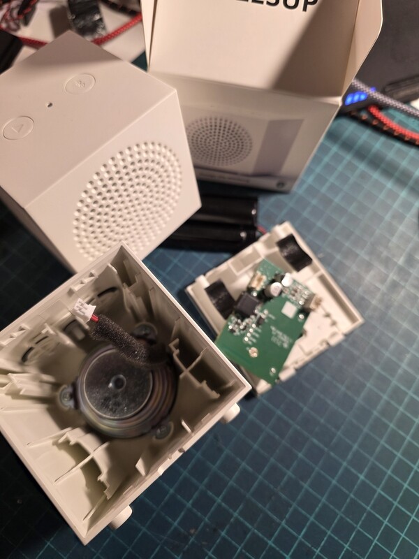

I just got some new IKEA KALLSUP speakers for just 5€.
Hopefully i find time to hack it :wink:
Yeah looks pretty hackable! :slight_smile:
In worst case just glue everything up.
1st test successful.
Got some nice sound (at least for 5€) out of it with a ESP32-C5 and a MAX98357A.
Now i have to modify the hardware :wink:

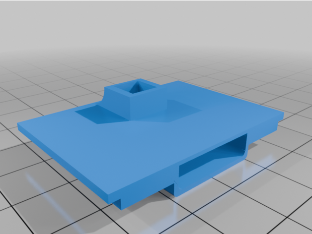

It should be doable to design a mount for the board and the two buttons, similiar to the VAPPEBY one.
