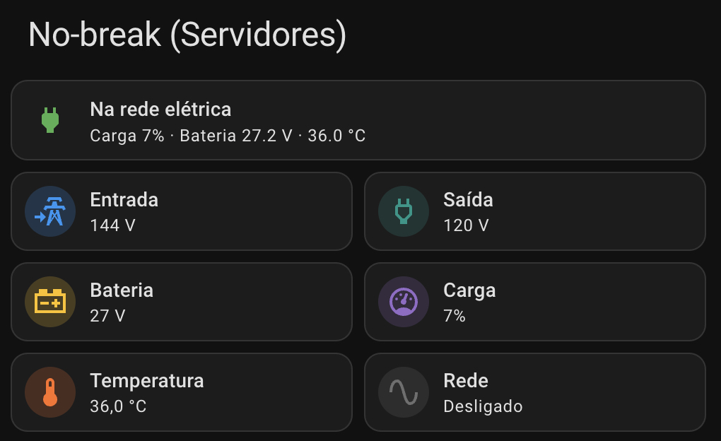

What you get in HA: input/output voltage, battery voltage, load %, temperature and an “on battery” binary sensor — plus a Mushroom + mini-graph dashboard.
