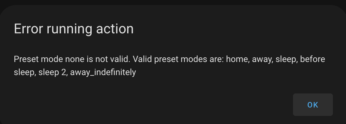

Even though the state of the climate entity is looking like this already:
Setting it again to “none” worked. “PRESET_NONE” did not.
It could not find a way to do it through the UI though because it always shows None and the combobox does not trigger an event when reselecting the “none” entry.
Here’s my test service call
Thanks for your help!
