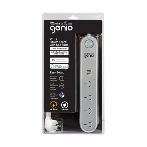

Hi, I have power board that I’ve flashed with an ESP-Home binary. It shows up on the ESP Home configuration page no problem, but it doesn’t control the power sockets (they just remain on).
Can I try Tasmota instead? I have the OTA update available on the device web page, but I am not sure which file I should use for the OTA Update.
I’m assuming I need some sort of Tasmota basic file, so I can load a template into it.
This is the template I would like to use if that matters…
Thanks.
Yes you can use tasmota, and there are instructions above for changing a esphome device to a tasmota device.
Or of course you could fix your esphome config. There is a similar model here https://esphome-configs.io/devices/mirabella-genio-i002340_plug/ and fundamentally it should be no different to https://esphome-configs.io/devices/brilliant-smart-powerboard/ or https://esphome-configs.io/devices/arlec-pb89ha_plug/ . You just have to allow for the different GPIO pins assignments.
Thanks nick, I did get it working with ESP home in the end. Works very well for anyone considering purchasing and flashing.
Can you write it up on esphome-configs.io please?
Its a bit of a story, but I ended up using the same configuration published on esphone-configs.io.
