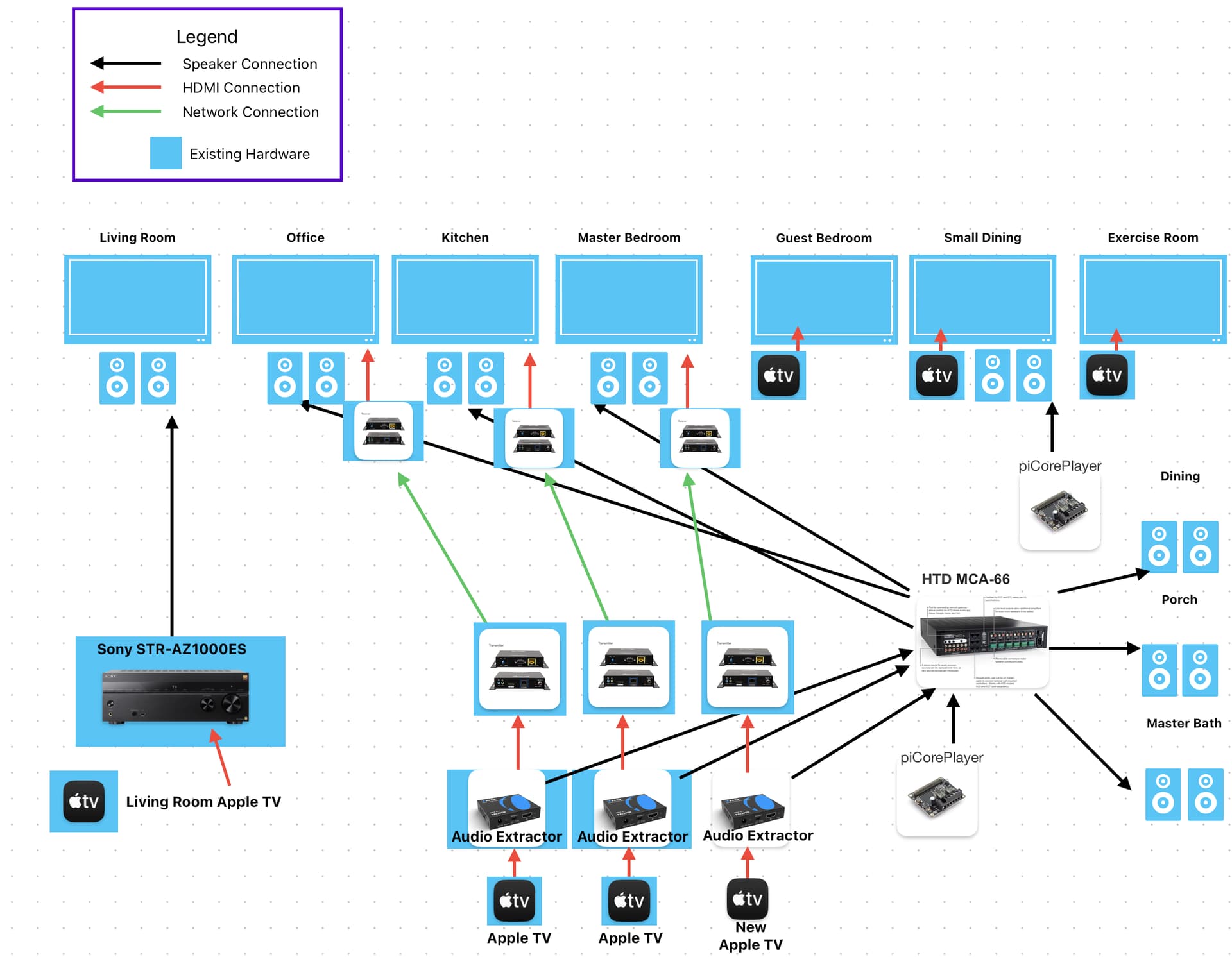

I’m replacing my Savant system. I’ve got most of it planned out but I’m torn on the the whole audio amp. These are the options I’m considering. A full Rpi/Amp solution will not work for my usecase.
  1. DAX88 - I like this choice for the 8 zones. Would require a serial controller (I’d probably get a Global Caché GC-100 since I’ll be needing IR control of a couple of devices). Also available for quick delivery.
  2. WS66i - Only 6 zones but has network control built in. Still would probably use GC-100 for IR control so I can have serial option for possible use later. Not necessarily quick delivery.
  3. HTD MCA-66. Also only 6 zones. Includes serial controller, and WiiM Mini. Newer integration. Lowest cost.
I’m kind of leanind towards the HTD now (I was about to pull the trigger on the WS66i when I found it). Mainly because of the extra pieces, and a new integration actively being developed with the manufacturer. At the same time, the WS66i is a core integration, so there’s that.

Thanks. My use doesn’t really work for a shift to Sonos. I don’t see a Denon that fits the need. A requirement is to continue to use the in-ceiling speakers.
Along with that is some Apple TV inputs that use that for the audio in those room. This is why I’m looking at these amps. Video is already distributed over Cat5e. I’ll split the audio out into the amps for the rooms that need it and fgive them each their own AppleTV (I’ll only need one more).
While music needs be playable (family uses Apple Music, and we have a Plex server. I’ve also set up LMS pointing at the same folder), it’s not the primary thing my family uses.
I linked to the HTD integration that came out in January. I think of the 3 choices I put out, they are the only one that specifically say they work with Home Assistant.
There a few reasons I’m dropping Savant. The main one is the inability to add/change things easily. While I have acess to the software on the host, I can’t get new profiles without paying an integrator. The equipment I have is also no longer supported which means a massive upgrade. One of the pieces is failing. I upgraded the main host a few years ago, so I’ll be getting an M1 Mac Mini to use for something else once I finish the change over.

Here’s my diagram- Pretty sure I’ll be able to do everything I want with this layout.
