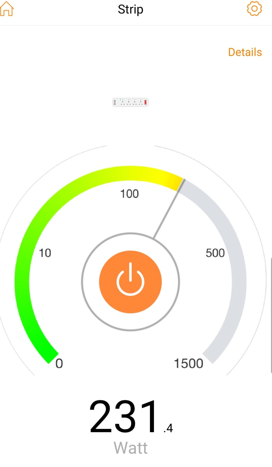

I have SOW020 UK plug type. I recently noticed in the android mobile app there is an option for local control (which doesnt need a cloud signin). Although I did setup first by signing up and adding my power strip to cloud account.
Now I can use local control and all the functions and power usage reading working just fine over LAN, i didnt do any firmware upgrade for the power strip until now, niether was there any pop up in the app to do so.
So the question is, since the local control is available, can we use it to make it workable within HA. I am not an expert , however I guess it would involve finding out the local URL and API calls the mobile app would be making. Any way we can harvest this to have it discovered and appear in HA.
Attaching some screenshots to show the local control options.
Thanks for your replies.
I am not an expert, however I can try to provide further info with technical guidance if needed to explore the possibilities.
