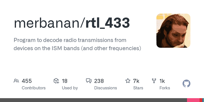

What is RTL433 in this setup?

I did not know the RTL433 worked with the Qiachip, I always thought you needed a CC1101 for that.
Actually using ESPhome
external_components:
  - source: github://juanboro/esphome-rtl_433-decoder/rtl_433.yaml
    components: [ rtl_433 ]
