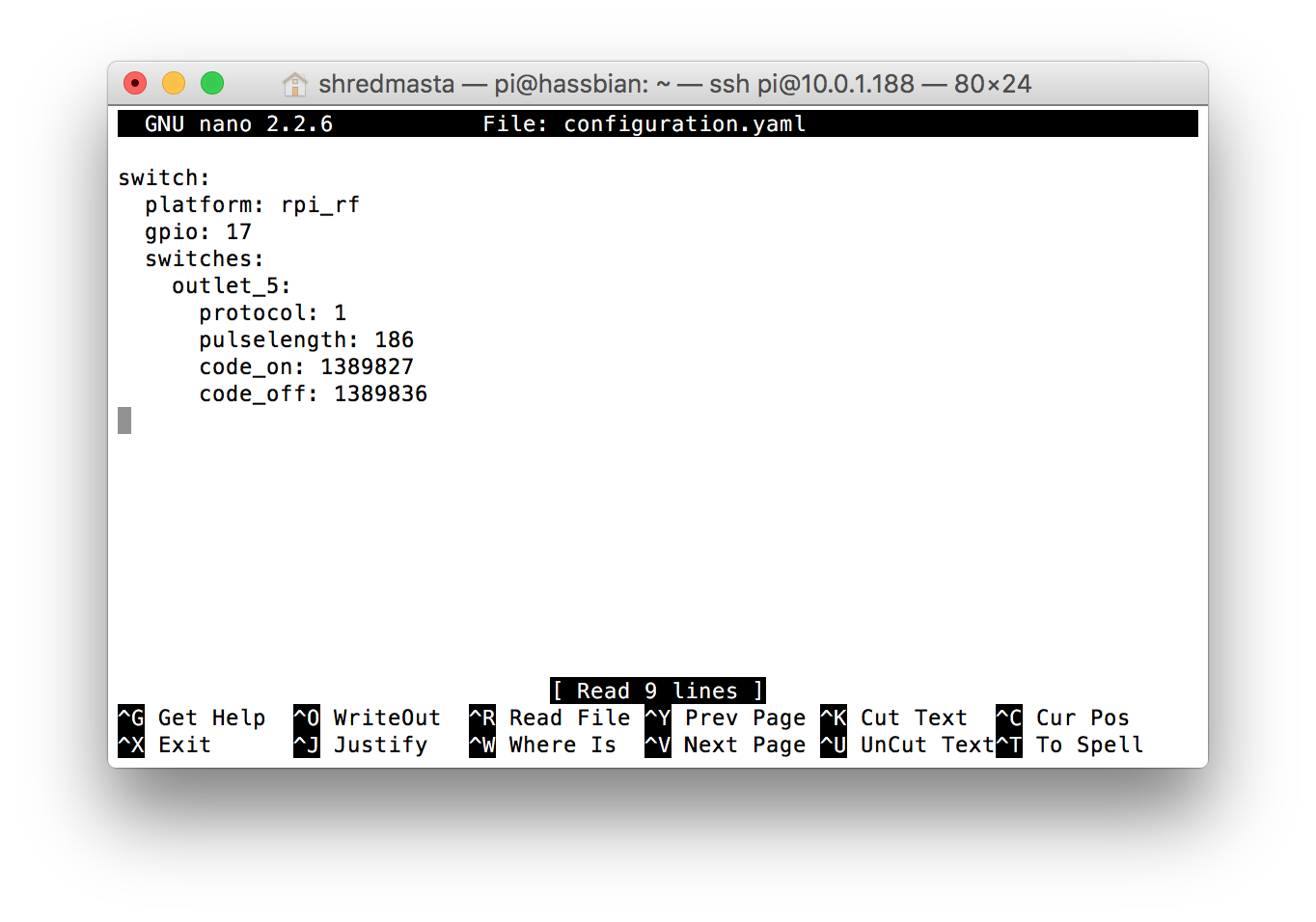

Everything seems ok until I try to edit the configuration.yaml file. This is my code:
I saved the code, and I know I need to restart Home Assistant. So I go to hassbian.local:8123/ and then go to Config. When I try to Restart, I see this red error message in the bottom left window: http://i.imgur.com/rsbS3RI.png

Hopefully you have more than just those few lines in your configuration.yaml file. The configuration you have listed above is not enough to run the whole Home Assistant package. It is only the section that you need to use the RF portion. Have you tried clicking the Check Config button? The restart won’t take place if the config is invalid. An invalid config can be the result of many things. From what you’ve posted above, it doesn’t look like your code has invalid spacing (read: that’s a big deal in the YAML language). The Check Config button should guide you in the right direction as far as coding, etc.

Assuming that you’ve done nothing else but add this RF module, your configuration.yaml file should look similar to this:
homeassistant:
  # Name of the location where Home Assistant is running
  # Location required to calculate the time the sun rises and sets
  latitude: 40.741895
  longitude: -73.989308
  # Impacts weather/sunrise data (altitude above sea level in meters)
  elevation: 12
  # metric for Metric, imperial for Imperial
  unit_system: imperial
  # Pick yours from here: http://en.wikipedia.org/wiki/List_of_tz_database_time_zones
  time_zone: America/New_York
# Show links to resources in log and frontend
introduction:
# Enables the frontend
frontend:
http:
  # Uncomment this to add a password (recommended!)
  # api_password: password
# Checks for available updates
updater:
# Discover some devices automatically
discovery:
# Allows you to issue voice commands from the frontend in enabled browsers
conversation:
# Enables support for tracking state changes over time.
history:
# View all events in a logbook
logbook:
# Track the sun
sun:
# Weather Prediction
sensor:
  platform: yr
# Switches
switch:
  platform: rpi_rf
  gpio: 17
  switches:
    outlet_5:
      protocol: 1
      pulselength: 186
      code_on: 1389827
      code_off: 1389836
