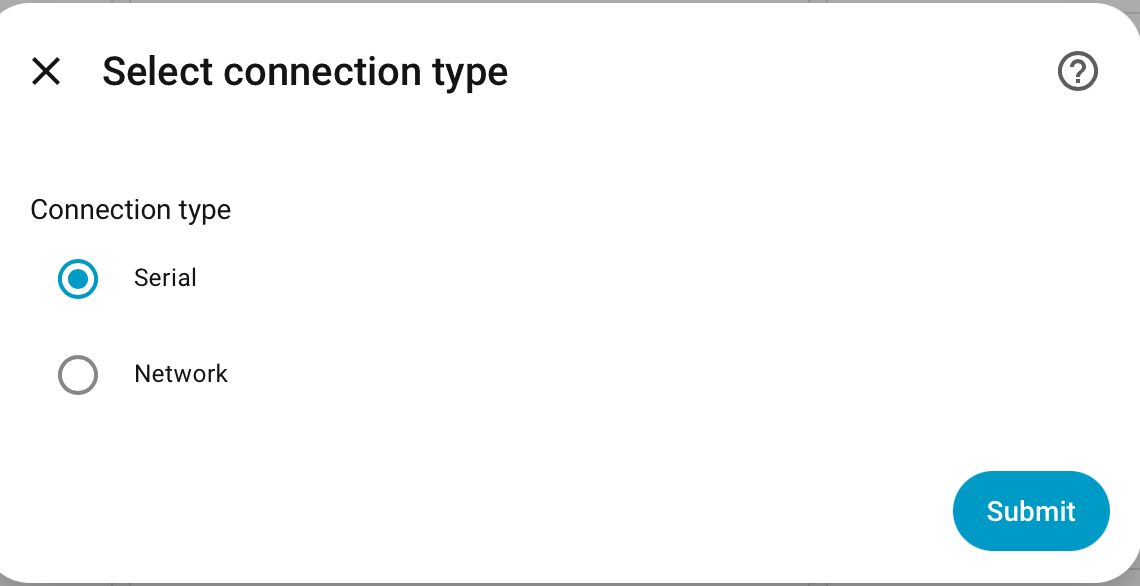

What I'm struggling with is setting up the RFXCOM HA add on. The add-on loads fine, and then asks me to select whether I can SERIAL or NETWORK. As I need it to be connected via WiFi I selected network. It then prompts for name/address of the RFXCOM, which I enter and also asked for a port. No matter what I put in there it doesn't seem to work. I've tried 10001 amongst others but no joy.

When using MQTT-WiFi or MQTT-LAN software in the RFX-433EMC :
Please read the RFX MQTT in Home Assistant.pdf, available on the RFXCOM Downloads page.
For MQTT you do not use the RFXCOM integration!!!
When using USB or WiFi software in the RFX-433EMC you must use the RFXCOM integration with port 10001 (see the RFX User Guide.pdf)
