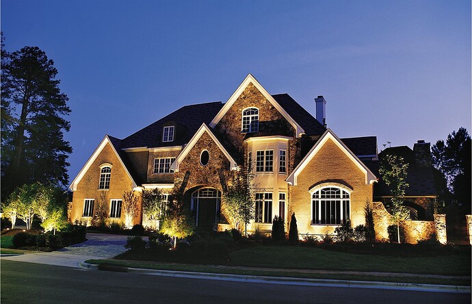

I’m looking to add some uplighting to my house like shown here.
Can anyone recommend a HA compatible RGBWW uplight? My preference is ESPhome, but would consider zigbee or a light that has an integration. I’d like bright lights that are also dimmable. But not being dimmable isn’t a deal breaker.
Does anyone have recommendations?

That’s not my house, I just found that on the internet to demonstrate what I’m looking for. This is my house I’m looking for lights for. :grinning:
