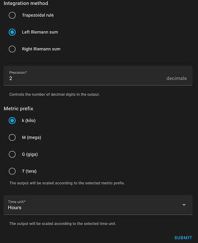

I can’t add a new Riemann integration because for energy, because every time I add a new helper
the metric become kkWhh instead of kWh
any ideas?

The Riemann Sum helper converts power (W or kW) to energy (Wh or kWh). You already have an energy sensor (kWh). You do not need to use this.
Mhm, strange; I have a lot of helpers with the same configuration and no one has that behavior. So, I will replace all of them with the sensor

The Riemann Sum helper in that case you show above is (correctly) using a power sensor.
Show the history graph for the sensor you are having trouble with.
